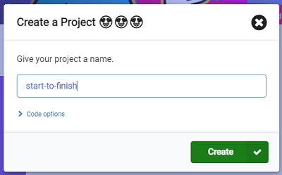

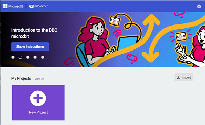

Click on the New Project in the top right. Give the project a name:
Name project

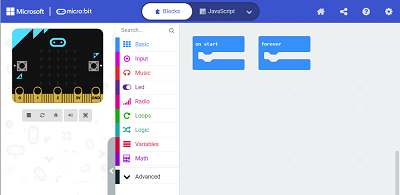

Click Create and you will see the code editor:

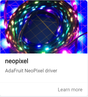

Then find the Neopixel block:
Neopixel extension
Click on it and you will see the Neopixel extension added:

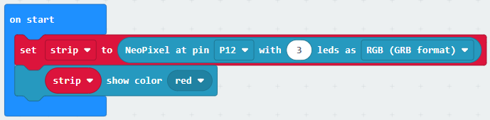

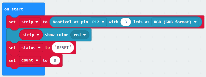

Now add code to set up the neopixel strip to show 3 red pixels. You can find the required code blocks in the Neopixel and Variables menus:
Code start neopixel
Add the code to set up the variables:
Code start vars

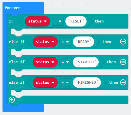

Add the logic for the different statuses that the game will have. We use an if..else if block to check if the game is in each state:
Code forever status

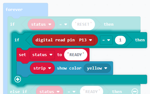

Add the code to move from the RESET state to the READY state. Pin 13 is the pin used by the green switch block. We will check if this switch is pressed and if it is then the game is ready:
Code forever reset to ready

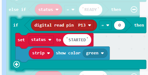

Add the code to move from the READY state to the STARTED state. The game starts when the green switch is released:
Code forever ready to started

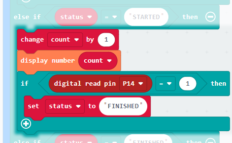

Add the code to run when the game is started. When the game starts, we want to start counting and displaying the count. When the purple switch is pressed (pin 14) we can set the game state to FINISHED:
Code forever started

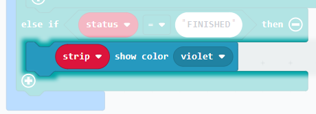

Add the code to run when the game is finished. When the game is finished we change the colour of the neopixels:
Code forever finished

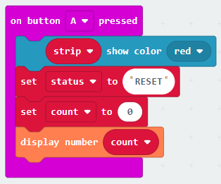

You will want to be able to reset the game, so that you can play again. Let's code the A button on the Microbit to reset the game. Build the following code block, which looks very similar to the code we entered in the on start block:
Code reset

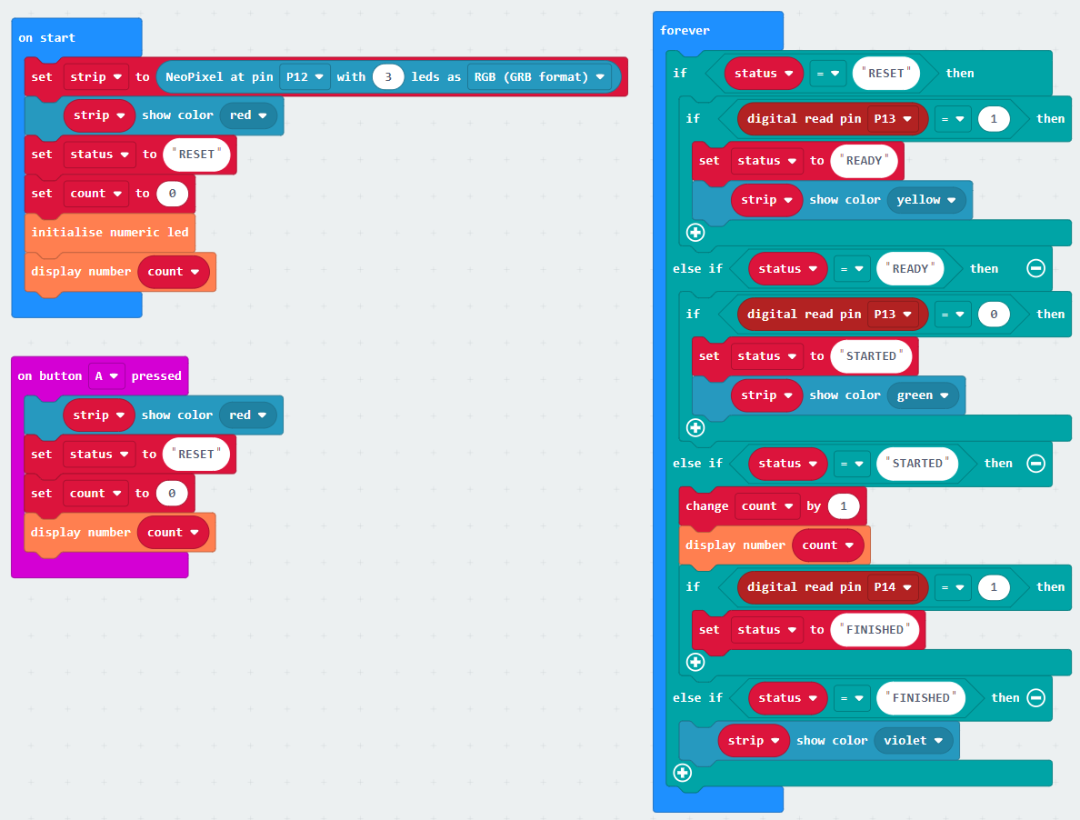

Complete code
If you have completed all of the above steps, your code should look like this:
Complete code
Download it onto the Microbit and run it.
